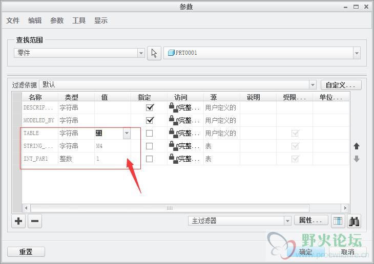

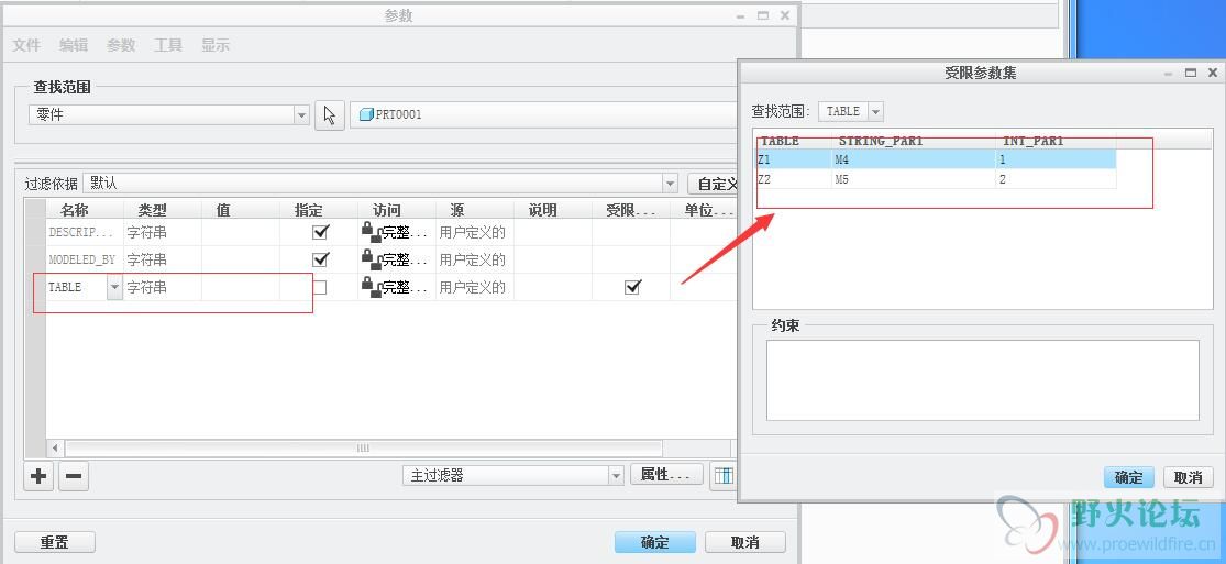

看了creo3.0的官方文档,一直因为格式不对,无法载入表格(*.lst),百度上也没答案。
现成功,案例分享如下:
ND_ParamDefArr_K01 = {
//受限制参数
{ Name = color_1
  Type = string
  Default = 'blue_new'
  Enum = { 'red_"new', 'green_new', 'blue_new' }
//受限制表格
{ Name = string_par1
  Type = string
  Table = Table
{ Name = int_par1
  Type = integer
  Table = Table
ND_ParamTable_K01 = {
NAME = Table
HEAD = string_par1,int_par1
ROWS ='Z1','M4',1
'Z2','M5',2
