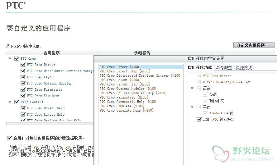

“DSM无法获得运行许可证”怎么解决?
  • 运行Distributed Services Manager无法启动,显示如下错误怎么办(别的Creo软件都运行正常)?
  • Creo 3.0怎么没有“Creo Distributed Batch”,批量打印图纸怎么办?

发表于 2017-2-22 21:50 | 显示全部楼层
如果你用的是 PTC_Creo_Patcher_0.1_SSQ.exe 补丁,注意看这句话做了没有
If you have installed PTC Creo 3.0 M100 Distributed Services Manager
Click "Look For..", browse to <Creo 3.0 Distributed Services Manager progdir> (by default C:\Program Files\PTC\Creo 3.0\Distributed Services Manager\) and click "Look For.." once again
Click "Start" and wait for patcher info window "All files seem to be patched. Enjoy!"
Click "OK"

 楼主| 发表于 2017-2-23 17:38 | 显示全部楼层
If you have installed PTC Cr ...
努力,认真解答网友的每一个问题,共同学习,一起进步!
确实是管理员真实的新生。
我不严谨了,以为Creo能运行就破解完了,却没仔细看文档,管理员的办法解决了我的问题。
谢谢
