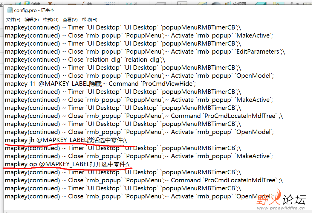

creo 映射键设置,其中关于装配件中选中零件激活与打开映射键没有反应,帮忙指导一下哪里出了问题,谢谢

发表于 2022-4-24 21:09 | 显示全部楼层
  1. mapkey qq @MAPKEY_LABEL激活;\
  2. mapkey(continued) ~ RButtonArm `main_dlg_cur` `PHTLeft.AssyTree` `node13`;\
  3. mapkey(continued) ~ PopupOver `main_dlg_cur` `PM_PHTLeft.AssyTree` 1 `PHTLeft.AssyTree`;\
  4. mapkey(continued) ~ Open `main_dlg_cur` `PM_PHTLeft.AssyTree`;\
  5. mapkey(continued) ~ Close `main_dlg_cur` `PM_PHTLeft.AssyTree`;\
  6. mapkey(continued) ~ Command `ProCmdMakeActive@PopupMenuTree`;

发表于 2022-4-24 21:10 | 显示全部楼层
  1. mapkey dq @MAPKEY_LABEL组建下open零件;\
  2. mapkey(continued) ~ RButtonArm `main_dlg_cur` `PHTLeft.AssyTree` `node19`;\
  5. mapkey(continued) ~ Trail `UI Desktop` `UI Desktop` `PREVIEW_POPUP_TIMER` \
  6. mapkey(continued) `main_dlg_w1:PHTLeft.AssyTree:<NULL>`;\
  7. mapkey(continued) ~ Close `main_dlg_cur` `PM_PHTLeft.AssyTree`;\
  8. mapkey(continued) ~ Command `ProCmdOpenModel@PopupMenuTree`;

 楼主| 发表于 2022-4-25 00:31 | 显示全部楼层
复制到我的config里面,还是无法使用这种映射键

发表于 2022-4-25 07:55 | 显示全部楼层
mapkey RR @MAPKEY_LABEL单独打开零件;~ Command `ProCmdOpenModel@PopupMenuGraphicWinStack`;

发表于 2022-4-25 07:56 | 显示全部楼层
mapkey BB @MAPKEY_LABEL 激活零件; ~ Command `ProCmdMakeActive@PopupMenuGraphicWinStack`;\

发表于 2022-4-25 09:49 | 显示全部楼层
wcs8848 发表于 2022-4-25 07:58
mapkey WW @MAPKEY_LABEL 隐藏选中; ~ Command `ProCmdViewHide@PopupMenuGraphicWinStack`;\
大佬挺牛呀,这样简洁的代码如何做出来的。挺好的省掉很多
228
273
发表于 2022-4-25 10:08 | 显示全部楼层
6楼和8楼应把最后的反斜杠“\”去掉
