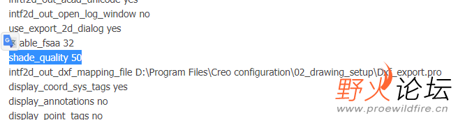

 楼主| 发表于 2022-3-25 11:59 | 显示全部楼层
今天有空,检查了一下CREO配置文件(config),发现了打开CREO文件后CPU及内存就爆满原因,是配置太多模型显示配置原因,如下
!#######model display#########
display_planes yes
display_axes no
display_coord_sys no
display_points no
spin_center_display no
pdf_use_pentable yes
allow_anatomic_features yes
menu_show_instances no
save_objects changed
save_object_in_current yes
!override_store_back yes
pipe_solid_centerline yes
compress_output_files yes
save_texture_with_model yes
dm_auto_open_zip yes
dm_cache_mode all
dm_overwrite_contents_on_update yes
dm_remember_server yes
dm_secondary_upload automatic
dm_upload_objects explicit
use_temp_interface_for_paste no
dxf_out_drawing_scale no
dxf_out_scale_views yes
photorender_preview_scale 1
fix_autocad_iges_text_scale yes
default_draw_scale 1
intf_out_layer part_layer
save_display yes
spin_with_orientation_center yes
spin_with_part_entities yes
sketcher_dimension_autolock yes
sketcher_lock_modified_dims yes
sketcher_starts_in_2d yes
sket_import_geometry_line_style yes
create_temp_interfaces no
auto_place_max_number 5
dxf_export_format 2000
dwg_export_format 2000
sketcher_dec_places 1
default_ang_dec_places 1
intf2d_out_stroke_text none
intf2d_out_acad_mtext yes
intf2d_out_acad_text_align as_is
inftf2d_out_acad_unicode yes
intf2d_out_open_log_window no
use_export_2d_dialog yes
enable_fsaa 32
shade_quality 50
intf2d_out_dxf_mapping_file D:\Program Files\Creo configuration\02_drawing_setup\Dxf_export.pro
display_coord_sys_tags yes
display_annotations no
display_point_tags no
display_axis_tags no
dm_cache_limit 16000
freeze_failed_cable_locations yes
tol_display yes
!load_ui_customization_run_dir yes
auto_add_remove yes
hlr_for_quilts yes
mass_property_calculate automatic
display_thick_cables yes
!mass_property_calculate by_request *
todays_date_note_format %yy-%mm-%dd
nmgr_outdated_mp do_not_show
save_file_iterations no
!symbol_font ISO
308
430
发表于 2022-4-25 20:47 | 显示全部楼层
只需要调整这一个就够了,调到10
