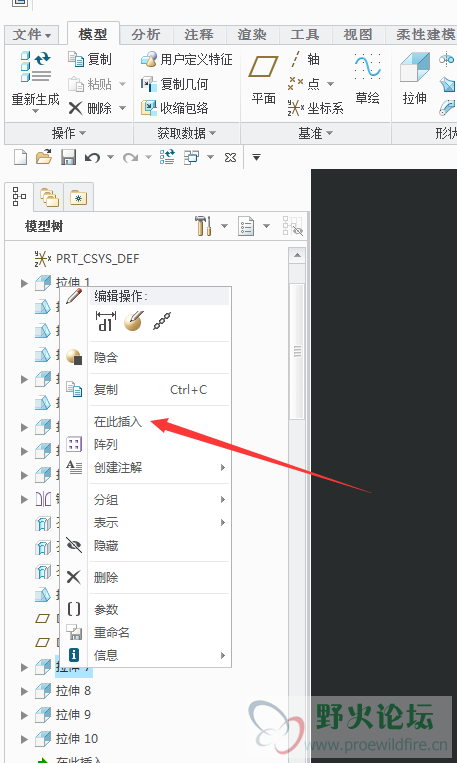

在creo3.0版本中,在模型树旁,“在此插入”的快捷键是怎么设置?

 楼主| 发表于 2019-6-4 10:28 | 显示全部楼层
就如这图

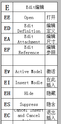

发表于 2019-6-4 11:17 | 显示全部楼层
mapkey ee @MAPKEY_LABEL打开;~ Command `ProCmdOpenModel` ;\
mapkey(continued) ~ Trail `UI Desktop` `UI Desktop` `PREVIEW_POPUP_TIMER` \
mapkey(continued) `main_dlg_w2HTLeft.AssyTree:<NULL>`;
mapkey ei @MAPKEY_LABEL在此插入;~ Command `ProCmdActivateInsert`;
mapkey ec @MAPKEY_LABEL退出插入并取消激活;%ec_1;%ec_2;%ec_3;%ec_4;%ec_5;
mapkey ec_1 @MAPKEY_LABEL退出插入模式;~ Command `ProCmdCancel` ;是;
mapkey ec_2 @MAPKEY_LABEL取消激活横截面;~ Command `ProCmdXsecSetInactive`;
mapkey ec_3 @MAPKEY_LABEL激活当前窗口;~ Command `ProCmdWinActivate`;
mapkey ec_4 @MAPKEY_LABEL全部取消隐藏;~ Command `ProCmdViewShowAll`;
mapkey ec_5 @MAPKEY_LABEL全部取消隐含;~ Command `ProCmdResumeAll`;
mapkey ed @MAPKEY_LABEL编辑定义;~ Command `ProCmdRedefine`;
mapkey ea @MAPKEY_LABEL编辑尺寸;~ Command `ProCmdL05Edit`;
mapkey ef @MAPKEY_LABEL编辑参考;~ Command `ProCmdReroute`;
mapkey ev @MAPKEY_LABEL激活;%ev_1;%ev_2;
mapkey ev_1 @MAPKEY_LABEL激活零件;~ Command `ProCmdMakeActive`;
mapkey ev_2 @MAPKEY_LABEL激活横截面;~ Command `ProCmdXsecSetActive`;
mapkey eh @MAPKEY_LABEL隐藏;~ Command `ProCmdViewHide`;
mapkey es @MAPKEY_LABEL隐含;~ Command `ProCmdSuppress` ;\
mapkey(continued) ~ Activate `del_sup_msg` `ok`;
