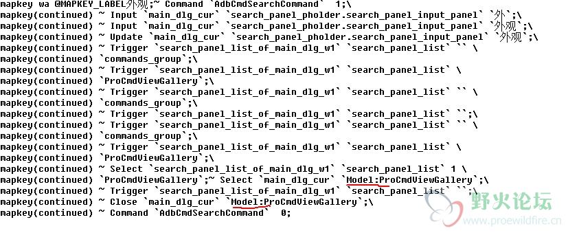

 楼主| 发表于 2016-10-22 01:06 | 显示全部楼层
暗菩提 发表于 2016-10-21 21:16
快捷键搞定打开外观库页面,流程是:开始录制之前请确认右上角放大镜栏是关的,开始录制mapkey——点击右上 ...
膜拜大神!
按楼上大神的指点,我录了原代码供同好者用(CREO3.0可用):
mapkey wa @MAPKEY_LABEL外观;~ Command `AdbCmdSearchCommand`  1;\
mapkey(continued) ~ Input `main_dlg_cur` `search_panel_pholder.search_panel_input_panel` `外`;\
mapkey(continued) ~ Input `main_dlg_cur` `search_panel_pholder.search_panel_input_panel` `外观`;\
mapkey(continued) ~ Update `main_dlg_cur` `search_panel_pholder.search_panel_input_panel` `外观`;\
mapkey(continued) ~ Trigger `search_panel_list_of_main_dlg_w1` `search_panel_list` `` \
mapkey(continued) `commands_group`;\
mapkey(continued) ~ Trigger `search_panel_list_of_main_dlg_w1` `search_panel_list` \
mapkey(continued) `ProCmdViewGallery`;\
mapkey(continued) ~ Trigger `search_panel_list_of_main_dlg_w1` `search_panel_list` ``;\
mapkey(continued) ~ Select `search_panel_list_of_main_dlg_w1` `search_panel_list` 1 \
mapkey(continued) `ProCmdViewGallery`;~ Select `main_dlg_cur` `Model:ProCmdViewGallery`;\
mapkey(continued) ~ Close `main_dlg_cur` `Model:ProCmdViewGallery`;\
mapkey(continued) ~ Command `AdbCmdSearchCommand`  0;
