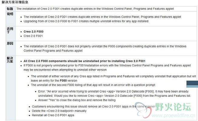

creo2.0 F001 官网解释
标题
The installation of Creo 2.0 F001 creates duplicate entries in the Windows Control Panel, Programs and Features applet
说明
Upgrading from of Creo 2.0 F000 to F001 creates multiple uninstall entries for any app installed
适用于
Creo 2.0 F000
Creo 2.0 F001
原因
The installation of Creo 2.0 F001 does not properly uninstall the F000 components creating duplicate entries in the Windows Control Panel Programs and Features applet
解决方案
All Creo 2.0 F000 components should be uninstalled prior to installing Creo 2.0 F001
If F000 is not properly uninstalled prior to F001installation errors with the Windows Control Panel Programs and Features applet may be encountered when attempting to uninstall either version
The uninstall of either version of any Creo app listed in Programs and Features will completely uninstall that application but will leave an entry for the F000 version
The uninstall of the second F000 listing of that app will result in an error with a question prompt:
Error: "An eror ocurred while trying to uninstall Creo <app> Version 2.0 Datecode [F000]. It may have been already uninstalled. Would you like to remove Creo <app> Version 2.0 Datecode [F000] from the Programs and Features list.
Answer "Yes" to close the dialog box and remove the listing
Customers encountering this issue should remove all Creo 2.0 F001 apps in the same manner
Delete the <Creo 2.0 loadpoint> manually
Reinstall all Creo 2.0 F001 apps

谁翻译成中文大概的意思呢
47
发表于 2012-4-25 20:28 | 显示全部楼层
是不是说安装后删除的问题呢
1288
47504
发表于 2012-4-25 21:08 | 显示全部楼层
看说明主要是解决卸载问题的吧
