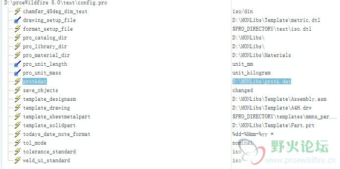

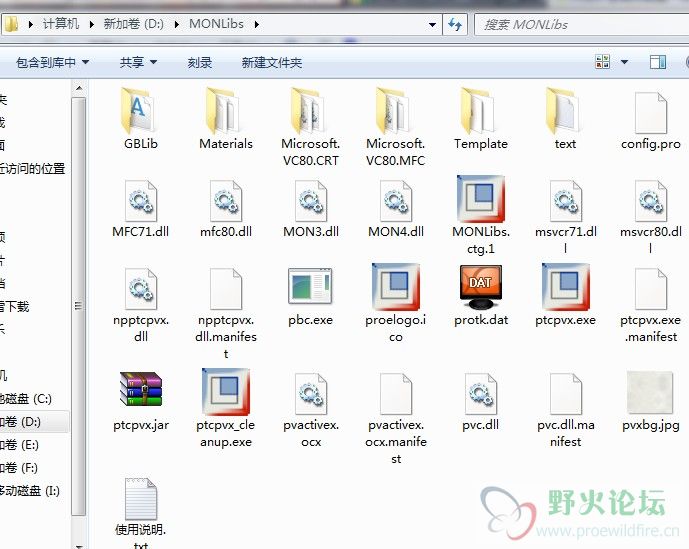

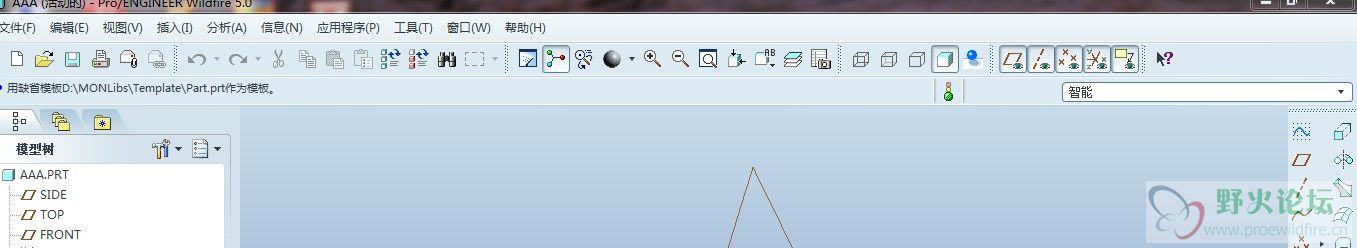

对protk.dat已修改
        EXEC_FILE  D:\MONLibs\MON4.dll
