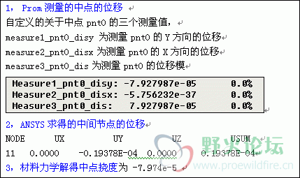

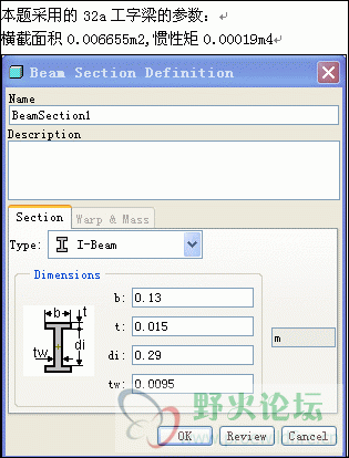

31a的工字梁,跨度2m,两端固定,在其中心线上承受线载荷P=20000N,弹性模量220Gpa,泊松比0.3.
问题“
1,
三种方案对比,proM的求解值和理论解比较接近,而ANSYS的解相差太大了,哪步出错了?,
2,
在proM中,自定义测量两端点的支反力时,源文件为measure.prt
Measure4_zuostressx为测量左端点的X方向的内力
Measure6_zuostressy为测量左端点的Y方向的内力
运行静态分析,诊断提示错误,见下图
为什么测量不了两端点的内力?
ANSYS的APDL
/prep7
et,1,BEAM3
r,1,0.006655,0.00019,0.32
mp,EX,1,2.2e11
mp,PRXY,1,0.3
sectype,1,BEAM,I
secdata,0.13,0.13,0.32,0.015,0.015,0.0095
k,1
k,2,2
l,1,2,20
lmesh,1
finish
/solu
node1=node(0,0,0)
node2=node(1,0,0)
node3=node(2,0,0)
d,node1,all
d,node3,all
f,node2,FY,-20000
solve
finish
/post1
plnsol,u,y
prrsol  !列出反作用结果
proM与ansys源程序见下面的beam压缩包。
