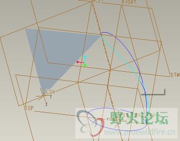

方程如下,画的时候说生成不了曲线,不知道怎么回事啊
关系里面的:
r=50
a=pi*r
afa=60
h=145
b=145
tanb=a/b
e=(1/2*a*a-2*r*r)/(h*(1+sin(afa))-a*tanb-2*r*r*cos(afa))
θ=h-((e*(tanb)*(r*pi*t-r*sin(t*180))+r*(e*cos(afa)-r)*(1-cos(t*180))+1/2*(r*pi*t)*(r*pi*t))/(e*(1+sin(afa))))
ξ=((b+e)*tanb)/(sin(52.544+θ)*sqrt((r*cos(t*180)-r+e*cos(afa))^2+(r*sin(t*180)+e*tanb)^2+(θ-e*sin(afa)-h)^2))
x=r-e*cos(afa)+(r*cos(t*180)-r+e*cos(afa))*ξ
y=-e*tanb+(r*sin(t*180)+e*tanb)*ξ
z=e*sin(afa)+h+(θ-e*sin(afa)-h)*ξ
以CS0定义的坐标
