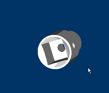

在运行快捷键时,主视图和左视图可以自动变成线框样式的,俯视图就变不了!(在录制快捷键时已经把所有视图设为线框样式)
不知是为什么?是不是这个快捷键录得太长的缘故?
望高手指点迷津,不胜感激!
mapkey ht @MAPKEY_LABEL新建绘图;~ Command `ProCmdViewOrient` ;\
mapkey(continued) ~ Select `orient` `namedviewPH.NameVw_List`1  `Default`;\
mapkey(continued) ~ Activate `orient` `namedviewPH.NameVw_PB_Save`;是;\
mapkey(continued) ~ Activate `orient` `OkPB`;~ Command `ProCmdModelNew` ;\
mapkey(continued) ~ Select `new` `Type`1  `Drawing`;~ Activate `new` `OK`;\
mapkey(continued) ~ Select `dwg_create` `rad_format`1  `3`;\
mapkey(continued) ~ Open `dwg_create` `opt_drawing_size`;\
mapkey(continued) ~ Close `dwg_create` `opt_drawing_size`;\
mapkey(continued) ~ Select `dwg_create` `opt_drawing_size`1  `A4`;\
mapkey(continued) ~ Activate `dwg_create` `psh_ok`;\
mapkey(continued) ~ Activate `main_dlg_cur` `resizer_button_1`1 ;\
mapkey(continued) ~ Timer `UI Desktop` `UI Desktop` `popupMenuRMBTimerCB`;\
mapkey(continued) ~ Command `ProCmdDwgPageSetup` ;~ Arm `pagesetup` `TblFormats`2  `1` `fmt`;\
mapkey(continued) ~ Select `pagesetup` `TblFormats`2  `1` `fmt`;\
mapkey(continued) ~ Activate `pagesetup` `ChkShowFmt`0 ;~ Activate `pagesetup` `OK`;\
mapkey(continued) ~ Command `ProCmdDwgViewGen` ;@PAUSE_FOR_SCREEN_PICK;\
mapkey(continued) ~ Select `drawing_view` `options_list`1  `ViewDisp`;\
mapkey(continued) ~ Open `drawing_view` `disp_style_rad`;\
mapkey(continued) ~ Close `drawing_view` `disp_style_rad`;\
mapkey(continued) ~ Select `drawing_view` `disp_style_rad`1  `nohidden`;\
mapkey(continued) ~ Select `drawing_view` `options_list`1  `Type`;\
mapkey(continued) ~ Select `drawing_view` `view_names_list`1  `Default`;\
mapkey(continued) ~ Activate `drawing_view` `psh_ok`;\
mapkey(continued) ~ Activate `drawing_view` `psh_apply`;\
mapkey(continued) ~ Select `drawing_view` `orient_method_op`1  `geometry_ref`;\
mapkey(continued) @PAUSE_FOR_SCREEN_PICK;~ Open `drawing_view` `OrientRef2`;\
mapkey(continued) ~ Close `drawing_view` `OrientRef2`;\
mapkey(continued) ~ Select `drawing_view` `OrientRef2`1  `Left`;@PAUSE_FOR_SCREEN_PICK;\
mapkey(continued) ~ Command `ProCmdDwgViewProj` ;@PAUSE_FOR_SCREEN_PICK;\
mapkey(continued) ~ Command `ProCmdEditProperties` ;\
mapkey(continued) ~ Select `main_dlg_cur` `MenuBar1`1  `Windows`;\
mapkey(continued) ~ Close `main_dlg_cur` `MenuBar1`;\
mapkey(continued) ~ Activate `main_dlg_cur` `Windows.psh_win_activate`;\
