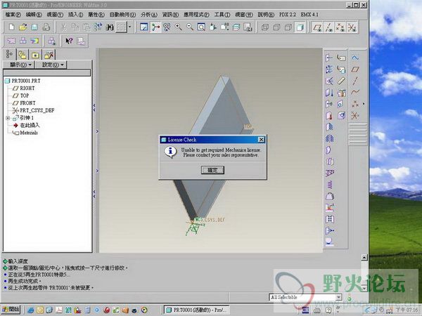

我按照本网站的说明安装ptc.pro mechanica.wildfire.3.0,并照演示。结果出现这个提示。不知道何处出错。授权文件都是使用本网站下载的。请教那里弄错了!

晕了。兄弟你截图时只截提示部分好不好,不然看不清你那提示是什么意思啊。

看提示是找不到许可证,请运行 mechWildfire 3.0\bin 下 ptcsetup.bat 指定许可证位置
注意截图只需要截取错误提示对话框即可

謝謝各位.我已知道是怎麼回事.
重新啟動你的電腦
.boot up your pc with windows
開始安裝pro/e軟件.
.start pro/e setup
打開授權文件,編輯修改硬件網卡 xx-xx-xx-xx-xx為本機的真實ID.
.open ptc_licfile.dat with your fav txt-editor
.replace every occurance of <HOSTID> with the one shown in the bottom left corner of the Pro/e setup
(its your mac-id, format: xx-xx-xx-xx-xx)
安裝PRO/engineer,PRO/mechanica等組件.
.install pro/e - pro/m - pro/ds, i dont care which one or in which order
選擇鎖定授權文件.
.on license-config screen select "nodelocked license" and point to edited ptc_licfile.dat
破解安裝.
.blalala install
破解Pro/Engineer
next for pro/engineer:
拷備ptc.pro engineer.wildfire.3.0.generic-patch.exe到pro/e installdir> \i486_nt\obj 目錄.並運行破解程序.
(if u didnt install the complete package, u get "missing file" errors, accept or bleed)
.run ptc.pro engineer.wildfire.3.0.m060-patch.exe, point to <installdir>\i486_nt\obj folder
.edit <pro/e installdir>\bin\proev.bat
  change "%start_cmd% "%CGTECH_JRE%\bin\javaw" -Xms16m -Xmx64m -Xss4m -classpath "%CGTECH_CLASSES%;%CGTECH_CLASSES%\CGTech.jar" Vericut %argstr%" in
        "%start_cmd% "%CGTECH_JRE%\bin\javaw" -Xms16m -Xmx64m -Xss4m -classpath "%CGTECH_CLASSES%;%CGTECH_CLASSES%\CGTech.jar" Vericut %argstr% PTC_KEY=0"
(add PTC_KEY=0)
破解Pro/Mechanica
拷備ptc.pro mechanica.wildfire.3.0.generic-patch.exe到pro/m installdir>\i486_nt\bin; pro/m installdir>\i486_nt\obj; pro/m installdir>\i486_nt\ptc目錄.並運行破解程序.
.run ptc.pro mechanica.wildfire.3.0.m060-patch.exe
.point to <pro/m installdir>\i486_nt\bin
                                         <pro/m installdir>\i486_nt\obj
                                         <pro/m installdir>\i486_nt\ptc
(in this order, after every "missing file" error)
用寫字板pro/e installdir>\bin的proe1.psf中ENV=MECH_LP=指向pro/m installdir如:
ENV=MECH_LP=C:\Program Files\mechWildfire 3.0
pro/distributed services:
.run ptc.distributed.services.m060-patch.exe and point to <pro/ds installdir>\i486_nt\obj
Have Fun Team SHooTERS !!!
