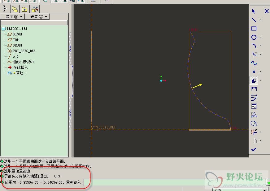

求助,proe中曲线偏移
怎样改变范围让曲线实现偏移???
曲线方程:
r0=32.310
r01=20.120
r02=25.720
n=9
e=(r02-r01)/2
r00=r0/n
rr=r0-r02+e
    a=t*360/(n-1)
    xa=(r0-r00)*cos(a)
    ya=(r0-r00)*sin(a)
    xb=r0*cos(a)
    yb=r0*sin(a)
    xc=xb+e*cos(n*a)
    yc=yb+e*sin(n*a)
    k=atan((yc-ya)/(xc-xa))
    x=xc-rr*cos(k)
    y=yc-rr*sin(k)
z=0
便宜失败
曲线方程:
r0=34.878
r01=22.542
r02=28.614
n=9
e=(r02-r01)/2
r00=r0/n
rr=r0-r02+e
    a=t*360/(n-1)
    xa=(r0-r00)*cos(a)
    ya=(r0-r00)*sin(a)
    xb=r0*cos(a)
    yb=r0*sin(a)
    xc=xb+e*cos(n*a)
    yc=yb+e*sin(n*a)
    x=xc-rr*cos(k)
    y=yc-rr*sin(k)
    z=0
便宜成功
为什么啊 求助????
