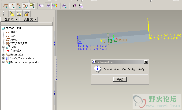

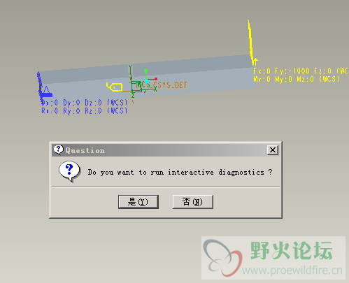

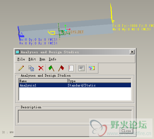

我在做静态分析时,材料,约束,载荷都定义了,但不能求解,出现can not  start the design study?

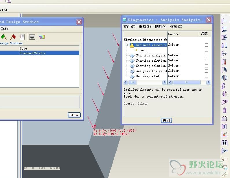

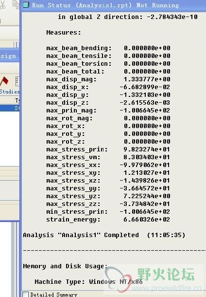

发表于 2009-4-8 11:30 | 显示全部楼层
可以分析,没有问题啊!
Excluded elements may be required near one or more
loads due to concentrated stresses.
No errors were found in the model.
Analysis1.rar
1.95 KB, 下载次数: 21

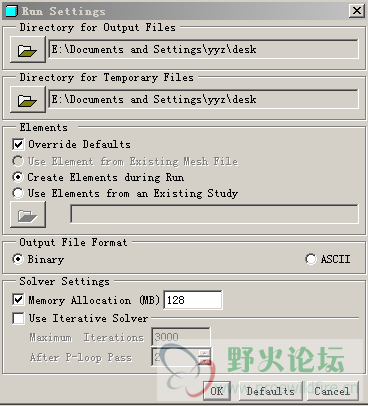

发表于 2009-4-8 11:48 | 显示全部楼层
发一下你的run setting看看
 楼主| 发表于 2009-4-8 21:42 | 显示全部楼层
会不会是我的Proe有问题啊!!
