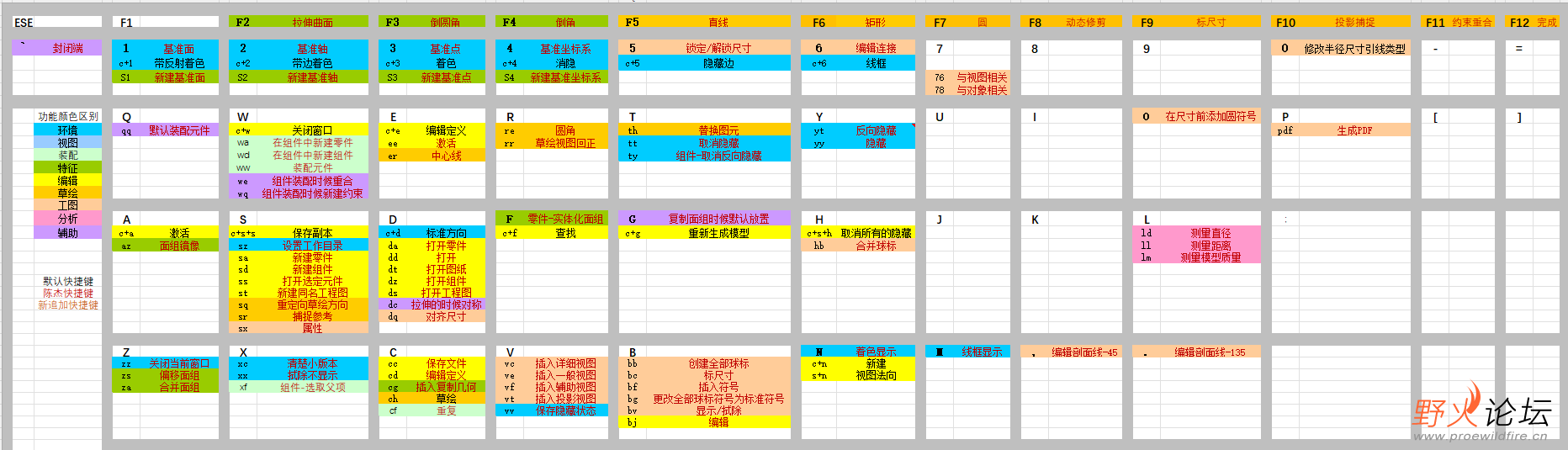

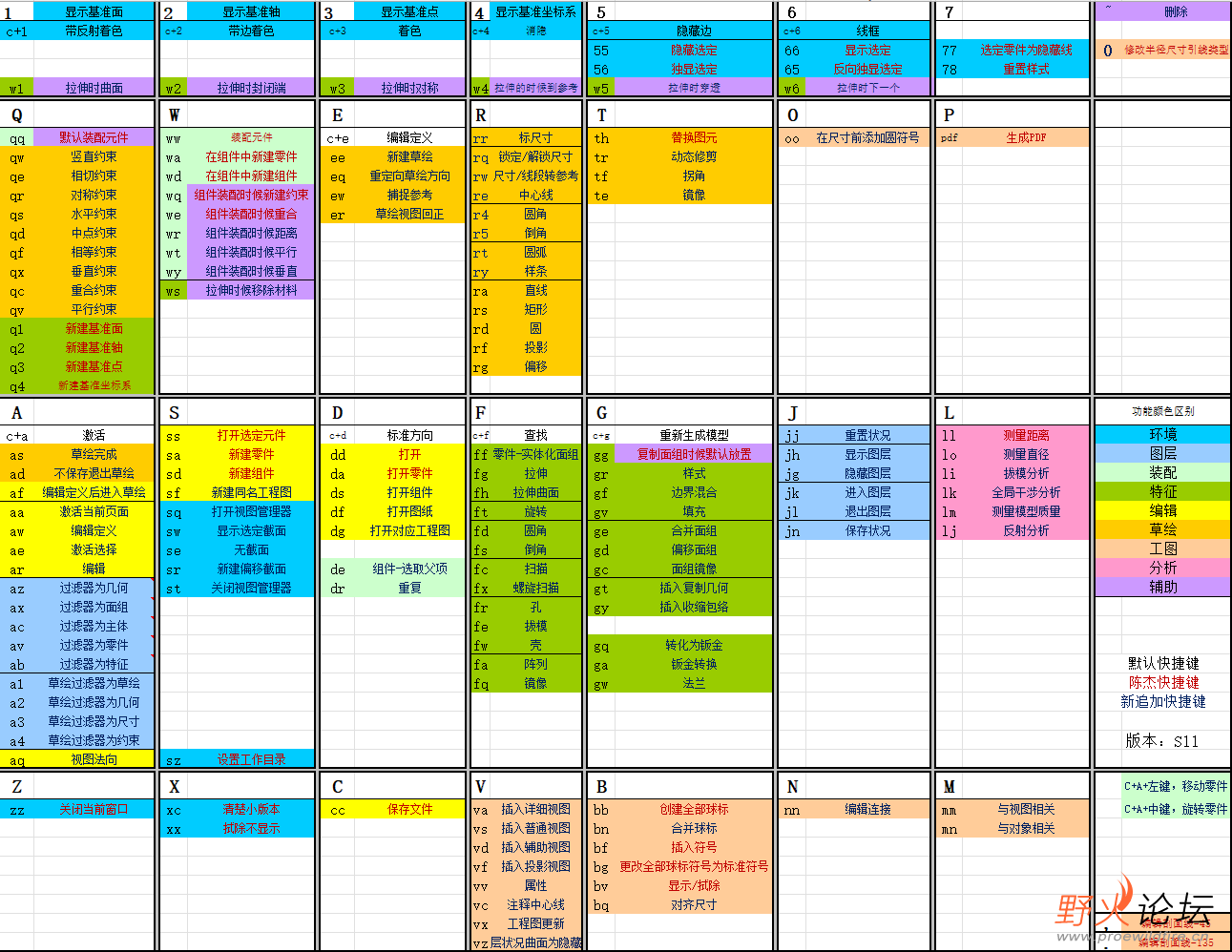

!杰哥文件基础上更改的快捷键
!Creo快捷键
!手按常用快捷键
mapkey fd @MAPKEY_LABEL零件-倒圆角;~ Command `ProCmdRound`;
mapkey fs @MAPKEY_LABEL零件-倒角;~ Command `ProCmdChamferEdge`;
mapkey fg @MAPKEY_LABEL拉伸;~ Command `ProCmdFtExtrude` ;\
mapkey(continued) ~ Trigger `extrev_1_placement.0.0` `PH.section_select_list` `0`;\
mapkey(continued) ~ Trigger `extrev_1_placement.0.0` `PH.section_select_list` ``;\
mapkey ft @MAPKEY_LABEL零件-旋转;~ Command `ProCmdFtRevolve`;
mapkey fc @MAPKEY_LABEL零件-扫描;~ Command `ProCmdFtLoft`;
mapkey fx @MAPKEY_LABEL零件-螺旋扫描;~ Command `ProCmdFtHelicalSweep`;
mapkey fr @MAPKEY_LABEL零件-孔;~ Command `ProCmdHole` ;\
mapkey(continued) ~ Trigger `hole_fb_plcmnt_page.0.0` `PH.ui_hole_prim_ref_cui_lst` `0`;\
mapkey(continued) ~ Trigger `hole_fb_plcmnt_page.0.0` `PH.ui_hole_prim_ref_cui_lst` ``;\
mapkey fe @MAPKEY_LABEL零件-拔模;~ Command `ProCmdDraft`;
mapkey fw @MAPKEY_LABEL零件-壳;~ Command `ProCmdShell`;
mapkey fa @MAPKEY_LABEL零件-阵列;~ Command `ProCmdPattern` ;\
mapkey(continued) ~ FocusOut `ui_pat_dim_panel.0.0` `PH.ui_pat_dim_1_array`;
mapkey fq @MAPKEY_LABEL零件-镜像;~ Command `ProCmdFtMirror`;
mapkey tr @MAPKEY_LABEL草绘-动态修剪;~ Command `ProCmdEditDelSeg`  1;
mapkey tf @MAPKEY_LABEL草绘-拐角;~ Command `ProCmdEditCorner`  1;
mapkey te @MAPKEY_LABEL草绘-镜像;~ Command `ProCmdEditMirror`  1;
mapkey ee @MAPKEY_LABEL零件-新建草绘;~ Command `ProCmdDatumSketCurve`;
mapkey eq @MAPKEY_LABEL草绘-重定向草绘方向;~ Command `ProCmdSketSetup`;
mapkey ew @MAPKEY_LABEL草绘-捕捉参照;~ Command `ProCmdSketReferences`;
mapkey er @MAPKEY_LABEL草绘-视图回正;~ Command `ProCmdViewSketchView`;
mapkey qc @MAPKEY_LABEL草绘-约束重合;~ Command `ProCmdSketAlignConstr`;
mapkey qw @MAPKEY_LABEL草绘-竖直约束;~ Command `ProCmdSketVerticalConstr`;
mapkey qe @MAPKEY_LABEL草绘-相切约束;~ Command `ProCmdSketTangentConstr`;
mapkey qr @MAPKEY_LABEL草绘-对称约束;~ Command `ProCmdSketSymmetryConstr`;
mapkey qs @MAPKEY_LABEL草绘-水平约束;~ Command `ProCmdSketHorizConstr`;
mapkey qd @MAPKEY_LABEL草绘-中点约束;~ Command `ProCmdSketMidPointConstr`;
mapkey qf @MAPKEY_LABEL草绘-相等约束;~ Command `ProCmdSketEqualConstr`;
mapkey qx @MAPKEY_LABEL草绘垂直直约束;~ Command `ProCmdSketOrthogConstr`;
mapkey qv @MAPKEY_LABEL草绘-平行约束;~ Command `ProCmdSketParallelConstr`;
mapkey as @MAPKEY_LABEL草绘-完成;~ Command `ProCmdSketDone`;
mapkey ad @MAPKEY_LABEL不保存退出草绘;~ Command `ProCmdSketQuit` ;\
mapkey(continued) ~ Activate `UI Message Dialog` `yes`;~ Enter `main_dlg_cur` `dashInst0.Quit`;\
mapkey(continued) ~ Activate `main_dlg_cur` `dashInst0.Quit`;
mapkey af %af1;%af2
mapkey af1 @MAPKEY_LABEL编辑定义后进入草绘-拉伸;\
mapkey(continued) ~ Activate `extrev_1_placement.2.0` `PH.Sketch`;
mapkey af2 @MAPKEY_LABEL编辑定义后进入草绘-旋转;\
mapkey(continued) ~ Activate `revolve_1_placement.1.0` `PH.Sketch`;
mapkey aa @MAPKEY_LABEL激活当前页面;\
mapkey(continued) ~ Key `main_dlg_cur` `proe_win` 9 1493 109 37814273 0 1794 1177 2560 1440 \
mapkey(continued) 237634 `Ctrl+A`;~ Command `ProCmdWinActivate`;
mapkey aw @MAPKEY_LABEL编辑定义;\
mapkey(continued) ~ RButtonArm `main_dlg_cur` `PHTLeft.AssyTree` `node6`;\
mapkey(continued) ~ PopupOver `main_dlg_cur` `PM_PHTLeft.AssyTree` 1 `PHTLeft.AssyTree`;\
mapkey(continued) ~ Open `main_dlg_cur` `PM_PHTLeft.AssyTree`;\
mapkey(continued) ~ Close `main_dlg_cur` `PM_PHTLeft.AssyTree`;\
mapkey(continued) ~ Command `ProCmdRedefine@PopupMenuTree`;
mapkey ae @MAPKEY_LABEL激活;\
mapkey(continued) ~ RButtonArm `main_dlg_cur` `PHTLeft.AssyTree` `node15`;\
mapkey(continued) ~ Command `ProCmdMakeActive@PopupMenuTree`;
mapkey ar @MAPKEY_LABEL编辑;\
mapkey(continued) ~ RButtonArm `main_dlg_cur` `PHTLeft.AssyTree` `node9`;\
mapkey(continued) ~ Command `ProCmdL05Edit@PopupMenuTree`;
mapkey mm @MAPKEY_LABEL绘图-与视图相关;\
mapkey(continued) ~ Activate `main_dlg_cur` `user_custom_page_190295048_control_btn` 1;\
mapkey(continued) ~ Command `ProCmdDwgRelToView`;
mapkey mn @MAPKEY_LABEL绘图-与对象相关;\
mapkey(continued) ~ Command `ProCmdDwgRelToObj`;
mapkey nn @MAPKEY_LABEL绘图-编辑连接;\
mapkey(continued) ~ Timer `UI Desktop` `UI Desktop` `popupMenuRMBTimerCB`;\
mapkey(continued) ~ Close `rmb_popup` `PopupMenu`;\
mapkey(continued) ~ Command `ProCmdDwgPopEditAtt@PopupMenuGraphicWinStack` ;\
mapkey(continued) ~ Activate `dtl_attref_ui` `ent_surf_toolbar` `psh_surf_att`;\
mapkey(continued) ~ Activate `dtl_attref_ui` `psh_surf_att`;
mapkey $F1 @MAPKEY_LABEL显示基准面;~ Command `ProCmdEnvDtmDisp`  1;
mapkey $F2 @MAPKEY_LABEL显示基准轴;~ Command `ProCmdEnvAxisDisp`  1;
mapkey $F3 @MAPKEY_LABEL显示基准点;~ Command `ProCmdEnvPntsDisp`  1;
mapkey $F4 @MAPKEY_LABEL显示基准坐标系;~ Command `ProCmdEnvCsysDisp`  1;
mapkey sz @MAPKEY_LABEL设置工作目录;~ Select `main_dlg_cur` `appl_casc`;\
mapkey(continued) ~ Activate `main_dlg_cur` `main_dlg_cur`;~ Close `main_dlg_cur` `appl_casc`;\
mapkey(continued) ~ Command `ProCmdSessionChangeDir` ;\
mapkey(continued) ~ Trail `UI Desktop` `UI Desktop` `DLG_PREVIEW_POST` `file_open`;
mapkey xx @MAPKEY_LABEL拭除不显示;~ Close `main_dlg_cur` `appl_casc`;\
mapkey(continued) ~ Command `ProCmdModelEraseNotDisp` ;~ Activate `file_erase_nd` `ok_pb`;
mapkey dd @MAPKEY_LABEL打开;~ Command `ProCmdModelOpen` ;\
mapkey da @MAPKEY_LABEL打开零件;~ Command `ProCmdModelOpen` ;\
mapkey(continued) ~ Trail `UI Desktop` `UI Desktop` `DLG_PREVIEW_POST` `file_open`;\
mapkey(continued) ~ Open `file_open` `Type`;~ Close `file_open` `Type`;\
mapkey(continued) ~ Select `file_open` `Type` 1 `db_2`;
mapkey dz @MAPKEY_LABEL打开组件;~ Command `ProCmdModelOpen` ;\
mapkey(continued) ~ Select `file_open` `Type` 1 `db_1`;
mapkey df @MAPKEY_LABEL打开图纸;~ Command `ProCmdModelOpen` ;\
mapkey(continued) ~ Select `file_open` `Type` 1 `db_4`;
mapkey sa @MAPKEY_LABEL新建零件;~ Command `ProCmdModelNew`;
mapkey sd @MAPKEY_LABEL新建组件;~ Command `ProCmdModelNew` ;\
mapkey(continued) ~ Select `new` `Type` 1 `Assembly`;
mapkey sf @MAPKEY_LABEL新建同名工程图;~ Command `CreateDrwCmdName` ;\
mapkey(continued) ~ Trail `UI Desktop` `UI Desktop` `PREVIEW_POPUP_TIMER` \
mapkey(continued) `file_openh_list.Filelist:<NULL>`;\
mapkey(continued) ~ Select `file_open` `Ph_list.Filelist` 1 `CreoWork9.0`;\
mapkey(continued) ~ Activate `file_open` `Ph_list.Filelist` 1 `CreoWork9.0`;\
mapkey(continued) ~ Select `file_open` `Ph_list.Filelist` 1 `templates`;\
mapkey(continued) ~ Activate `file_open` `Ph_list.Filelist` 1 `templates`;
mapkey sq @MAPKEY_LABEL打开视图管理器;~ Command `ProCmdViewVisTool` ;\
mapkey(continued) ~ Select `visual_dlg0` `RadioSelApplMgr` 1 `xsec`;
mapkey st @MAPKEY_LABEL关闭视图管理器;~ Close `visual_dlg0` `visual_dlg0`;
mapkey sw @MAPKEY_LABEL显示选定截面;\
mapkey(continued) ~ RButtonArm `visual_dlg0` `Table` 2 `00` `name_column`;\
mapkey(continued) ~ PopupOver `visual_dlg0` `EditPanel` 1 `Table`;\
mapkey(continued) ~ Open `visual_dlg0` `EditPanel`;~ Close `visual_dlg0` `EditPanel`;\
mapkey(continued) ~ Activate `visual_dlg0` `Activate`;
mapkey se @MAPKEY_LABEL无截面;\
mapkey(continued) ~ Arm `visual_dlg0` `Table` 2 `no cross section` `name_column`;\
mapkey(continued) ~ Select `visual_dlg0` `Table` 2 `no cross section` `name_column`;\
mapkey(continued) ~ RButtonArm `visual_dlg0` `Table` 2 `no cross section` `name_column`;\
mapkey sr @MAPKEY_LABEL新建偏移截面;~ Select `visual_dlg0` `ZoneCreateCasc`;\
mapkey(continued) ~ Close `visual_dlg0` `ZoneCreateCasc`;\
mapkey(continued) ~ Activate `visual_dlg0` `xsec_crt_sketch`;
mapkey wa @MAPKEY_LABEL在组件中新建零件;~ Command `ProCmdCompCreate` ;\
mapkey(continued) ~ Select `comp_create` `Type` 1 `a`;
mapkey wd @MAPKEY_LABEL在组件中新建组件;~ Command `ProCmdCompCreate` ;\
mapkey(continued) ~ Select `comp_create` `Type` 1 `b`;
mapkey zz @MAPKEY_LABEL关闭当前窗口;~ Command `ProCmdWinCloseGroup`;
mapkey qq @MAPKEY_LABEL组件-缺省装配;\
mapkey(continued) ~ Open `main_dlg_cur` `maindashInst0.constr_offset_type_2`;\
mapkey(continued) ~ Close `main_dlg_cur` `maindashInst0.constr_offset_type_2`;\
mapkey(continued) ~ Select `main_dlg_cur` `maindashInst0.constr_offset_type_2` 1 `Default`;\
mapkey(continued) ~ Activate `main_dlg_cur` `dashInst0.stdbtn_1`;
mapkey ss @MAPKEY_LABEL打开选定元件;\
mapkey(continued) ~ RButtonArm `main_dlg_cur` `PHTLeft.AssyTree` `node10`;\
mapkey(continued) ~ Command `ProCmdOpenModel@PopupMenuTree`;
mapkey ab @MAPKEY_LABEL零件状态下过滤器为特征;\
mapkey(continued) ~ Open `main_dlg_cur` `Sst_bar.filter_list`;\
mapkey(continued) ~ Close `main_dlg_cur` `Sst_bar.filter_list`;\
mapkey(continued) ~ Select `main_dlg_cur` `Sst_bar.filter_list` 1 `1`;\

整理后快捷键.pdf
95.68 KB, 下载次数: 35
