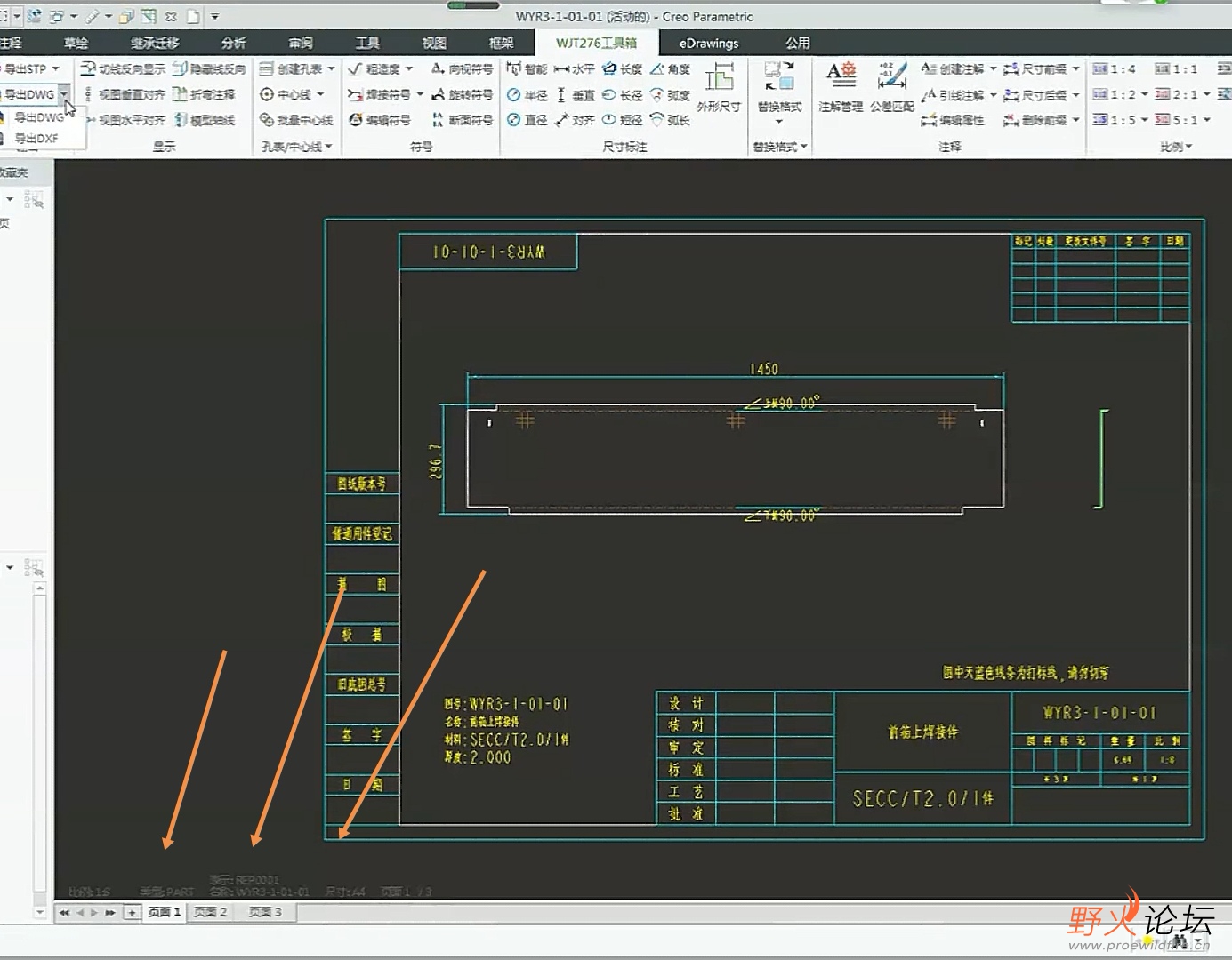

关于多页工程图,怎么设置默认全部页面导出到CAD dwg办法求助?
请问大神,客户发我很多工程图都是多页。
每次导cad都要手动选择 所有页面导出到dwg

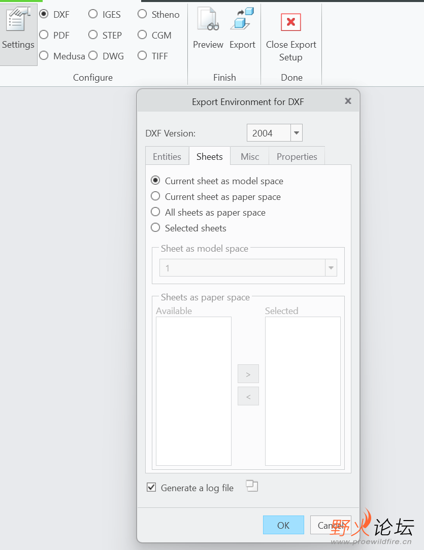

另存-导出-选择DXF-设置里选择所有页面,导出DWG格式不知道了

C10
  1. mapkey dw1 @MAPKEY_LABEL当前页面导出dwg;~ Command `ProCmdModelSaveAs` ;\
  2. mapkey(continued) ~ Open `file_saveas` `type_option`;~ Close `file_saveas` `type_option`;\
  3. mapkey(continued) ~ Select `file_saveas` `type_option` 1 `db_560`;\
  4. mapkey(continued) ~ Activate `file_saveas` `Current Dir`;~ Activate `file_saveas` `OK`;\
  5. mapkey(continued) ~ Select `export_2d_dlg` `ExportOptions_Tab` 1 `Sheets_Layout`;\
  6. mapkey(continued) ~ Activate `export_2d_dlg` `Export_Button`;\
  7. mapkey(continued) ~ Activate `UI Message Dialog` `ok`;~ Activate `export_2d_dlg` `OK_Button`;\
  8. mapkey(continued) ~ Activate `UI Message Dialog` `ok`;
  9. mapkey dw2 @MAPKEY_LABEL全部页面导出dwg;~ Command `ProCmdModelSaveAs` ;\
  10. mapkey(continued) ~ Open `file_saveas` `type_option`;~ Close `file_saveas` `type_option`;\
  11. mapkey(continued) ~ Select `file_saveas` `type_option` 1 `db_560`;\
  12. mapkey(continued) ~ Activate `file_saveas` `Current Dir`;~ Activate `file_saveas` `OK`;\
  13. mapkey(continued) ~ Select `export_2d_dlg` `ExportOptions_Tab` 1 `Sheets_Layout`;\
  14. mapkey(continued) ~ Select `export_2d_dlg` `SheetOpt_Group` 1 `all_paper`;\
  15. mapkey(continued) ~ Activate `export_2d_dlg` `OK_Button`;~ Activate `UI Message Dialog` `ok`;
复制代码
creo 11.0
