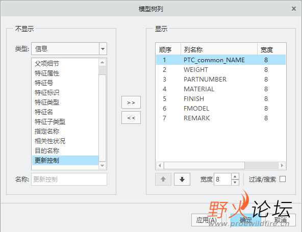

树列里面只有这些选项,我看别人的有很多参数里面自定义的类型,我在参数里添加了,但树列选项里还是没有

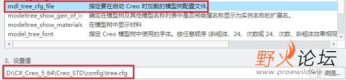

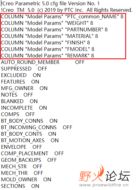

先找到第一张图里面对应的文件,然后打开参考第2张图添加你要的参数,最后效果就是第3张图一样

那试试自己建一个这个文件,把系统参数指向这个文件呢,内容如下
!Creo Parametric 5.0 cfg file Version No. 1
!Creo  TM  5.0  (c) 2019 by PTC Inc.  All Rights Reserved.
COLUMN "Model Params" "PTC_common_NAME" 8
COLUMN "Model Params" "WEIGHT" 8
COLUMN "Model Params" "PARTNUMBER" 8
COLUMN "Model Params" "MATERIAL" 8
COLUMN "Model Params" "FINISH" 8
COLUMN "Model Params" "FMODEL" 8
COLUMN "Model Params" "REMARK" 8
AUTO_ROUND_MEMBER        OFF
SUPPRESSED    OFF
EXCLUDED    ON
FEATURES    ON
MFG_OWNER    ON
NOTES    OFF
BLANKED    ON
INCOMPLETE    ON
COMPS    OFF
BT_BODY_CONNS    ON
BT_INCOMING_CONNS    OFF
BT_BODY_CONTS    ON
BT_MOTION_AXES    ON
ENVELOPE    OFF
COMP_PLACEMENT    OFF
GEOM_BACKUPS    OFF
MECH_STR    OFF
MECH_THR    OFF
MOLD_OWNER    ON
SECTIONS    ON

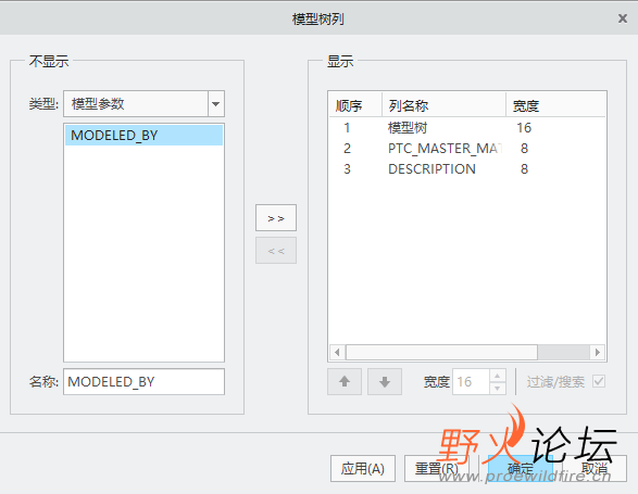

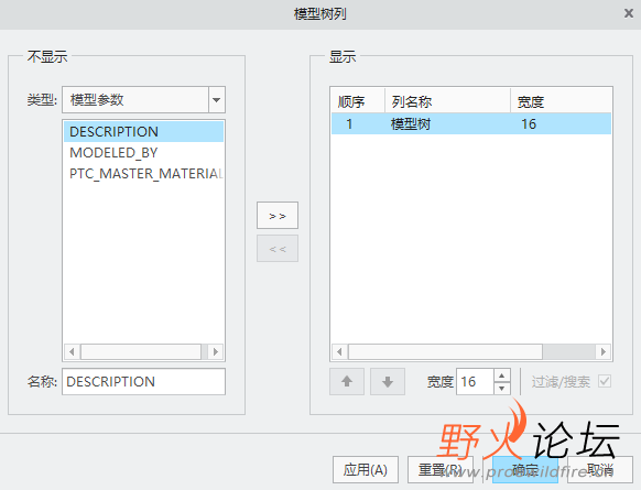

搞定了,直接在名称栏里填
