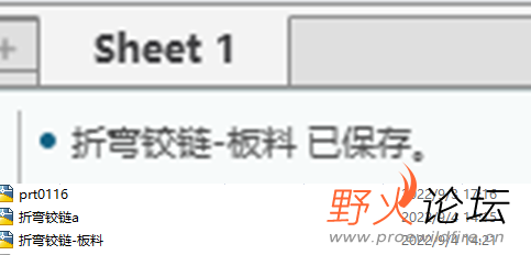

复制到“config.pro”中使用
快捷键F3
使用前将工作目录设置到目的文件夹,导出的DWG文件名可以是中文以及含特殊符号。

发表于 2022-9-3 22:19 | 显示全部楼层
mapkey dw @MAPKEY_LABEL输出DWG;\
mapkey(continued) ~ Activate `main_dlg_cur` `page_Publish_control_btn`1 ;\
mapkey(continued) ~ Command `ProCmdDwgPubSetDeliverable`  `DWG`;\
mapkey(continued) ~ Command `ProCmdDwgPubSettings` ;\
mapkey(continued) ~ Select `export_2d_dlg` `ExportOptions_Tab`1  `Misc_Layout`;\
mapkey(continued) ~ Select `export_2d_dlg` `AssemblyStructure_Group`1  `as_blocks`;\
mapkey(continued) ~ Activate `export_2d_dlg` `Nested_Button`1 ;\
mapkey(continued) ~ Activate `export_2d_dlg` `ViewBased_Button`1;\
mapkey(continued) ~ Activate `export_2d_dlg` `Dim_Breaks_Button`1 ;\
mapkey(continued) ~ Activate `export_2d_dlg` `OK_Button`;~ Command `ProCmdDwgPubPublish` ;\
mapkey(continued) ~ Activate `file_saveas` `Current Dir`;~ Activate `file_saveas` `OK`;\
mapkey(continued) ~ Activate `UI Message Dialog` `ok`;

你这种带中文的DWG不能导出

不用快捷键,可以?
