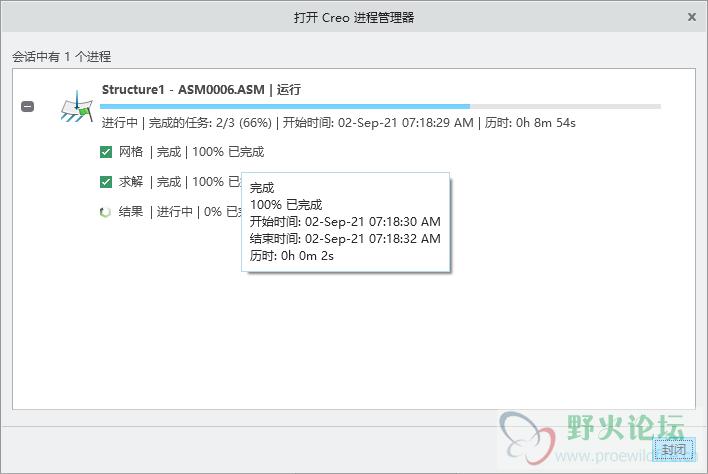

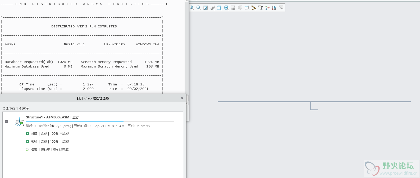

发表于 2021-9-2 07:26 | 显示全部楼层 |阅读模式
一个简单的计算,前期处理很快,但是结果一直出来。。。win10 21H1版本,i7 11800h+RTX3070,照理不应该出现这个问题。
怀疑过是许可证浮动问题,用了虚拟网卡还是有浮动提示。。。
大佬们有没有遇到过?

发表于 2021-12-18 17:21 | 显示全部楼层
我今天也碰到了,同样的模型,在creo simulation里几秒就出来了。 creo Ansys simulation一直卡在结果中。不知道是不是和显卡有关。

发表于 2022-1-16 20:49 | 显示全部楼层
有没有谁帮忙解答下,在官网上看到类似问题,但看不到解决方案。
https://www.ptc.com/en/support/article/CS349290
Creo ANSYS Result process hangs (shown as 0%) after mesh and resolve process in a special computer(Windows 10 Pro, NVIDIA Quadro T1000) in Creo Parametric
Modified: 20-Dec-2021
Applies To
Creo Parametric 7.0.4.0 to 8.0.2.0
Description
NVIDIA Quadro P1000 reported same issue
Creo Ansys Simulation does not proceed past 0% in results phase
Refer to the following test cases:
Even after changing the computer with a supported graphics card, Creo ANSYS Result hangs when running on a physical machine (Windows 10 Pro, NVIDIA Quadro T1000).
Open the model on the physical machine where Creo ANSYS Result is running normally on other computers, and re-run Creo ANSYS, the Result calculation proceeds normally.
Set the config option graphics win32_gdi, Creo ANSYS result still hangs
Referring to CS334044: Set this hidden config.pro option creo_ansys_distribute_solver manually to the value SMP, Creo ANSYS result still hangs
Running Creo 8.0.0.0 ANSYS on this computer, the same result hangs error
Customer test Windows 10 20H2, 1909 version, the same result hang error
Uninstall Intel(R) UHO Graphics driver, Creo modeling function is affected, running lag, can't enter Creo ANSYS environment, can't do Creo ANSYS simulation test
However, running Result on a virtual machine (Windows 10 Pro) on that physical machine works normally. Refer to the system information file of the physical machine and the virtual machine.

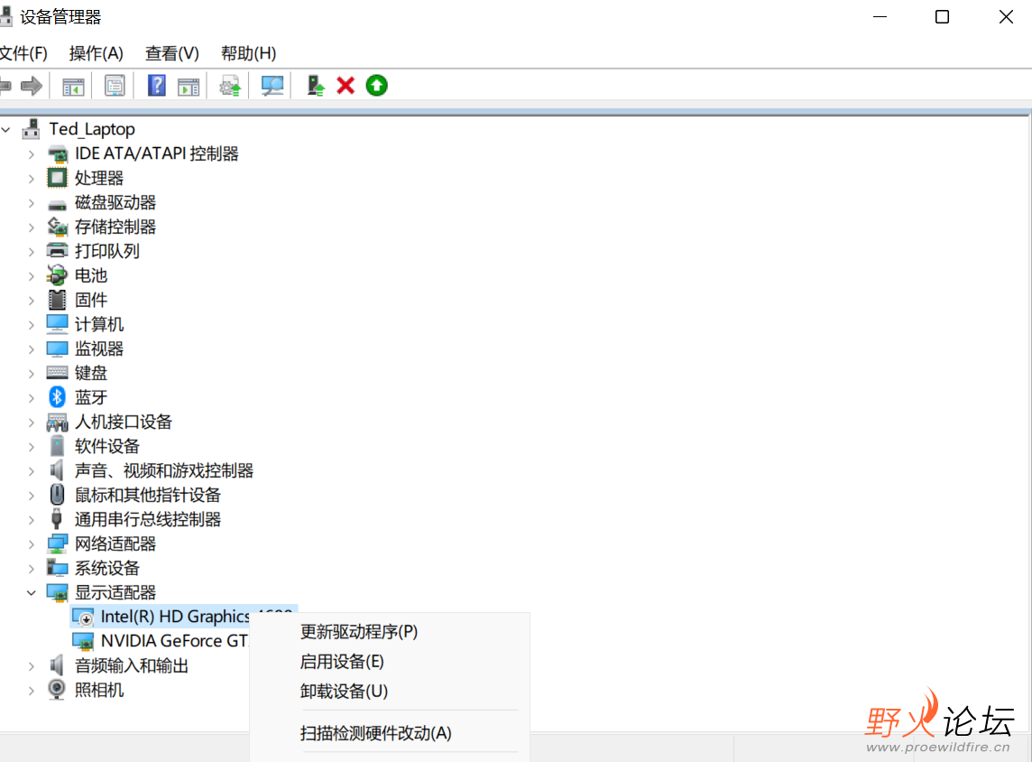

发表于 2022-2-10 00:30 | 显示全部楼层
把核显禁用,重启电脑可解决。

 楼主| 发表于 2022-2-10 12:47 | 显示全部楼层
ysx777 发表于 2022-2-10 00:30
把核显禁用,重启电脑可解决。
正解,不清楚为啥intel的核显不行,amd的就没有这个问题。

发表于 2022-9-26 13:52 | 显示全部楼层
笔记本电脑的话 这个问题是不是无解,因为笔记本电脑不能禁用核显

发表于 2022-10-23 00:12 | 显示全部楼层
直接在设备管理器里禁用了

发表于 2022-11-1 17:37 | 显示全部楼层
Ted_L 发表于 2022-10-23 00:12
直接在设备管理器里禁用了
http://www.proewildfire.cn/forum.php?mod=attachment&aid=MjczMTAxfDFmNDA5ZDMwfDE3NjEwMjI2Nzh8MHw%3D
禁用后卡的要死,好像是笔记本不管运算过程是否用独显,最终输出显示必须是集显
