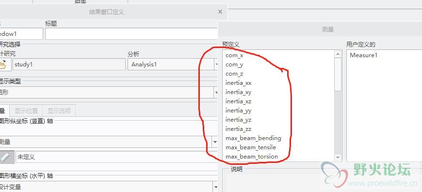

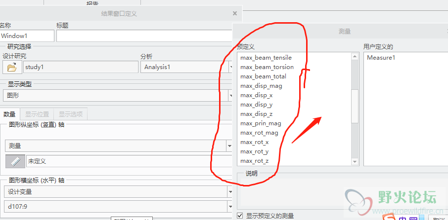

发表于 2020-2-26 15:49 | 显示全部楼层 |阅读模式
这些词汇  不知道含义 大部分都是缩写。求大神分享

发表于 2020-2-26 21:10 | 显示全部楼层
Name
Description
buck_load_factor
load factor for buckling mode
com_x
WCS X coordinate of center of mass
com_y
WCS Y coordinate of center of mass
com_z
WCS Z coordinate of center of mass
contact_area
total contact area over all contacts in the model
contact_max_pres
maximum pressure over all contacts in the model
inertia_xx
WCS XX component of moment of inertia
inertia_xy
WCS XY component of moment of inertia
inertia_xz
WCS XZ component of moment of inertia
inertia_yy
WCS YY component of moment of inertia
inertia_yz
WCS YZ component of moment of inertia
inertia_zz
WCS ZZ component of moment of inertia
max_beam_bending
maximum beam bending stress over model
max_beam_tensile
maximum beam tensile stress over model
max_beam_torsiona
maximum beam torsion stress over model
max_beam_totala
maximum beam tensile plus bending stress over model
max_disp_magb
maximum displacement over model
max_disp_x
maximum WCS X displacement over model
max_disp_y
maximum WCS Y displacement over model
max_disp_z
maximum WCS Z displacement over model
max_prin_magb
maximum magnitude principal stress over model
max_rot_magb
maximum rotation magnitude over model
max_rot_x
maximum over model of rotations about WCS X axis
max_rot_y
maximum over model of rotations about WCS Y axis
max_rot_z
maximum over model of rotations about WCS Z axis
max_stress_prinb
most positive principal stress over model
max_stress_vmb
maximum von Mises stress over model
max_stress_xx
maximum WCS XX stress component over model
max_stress_xy
maximum WCS XY stress component over model
max_stress_xz
maximum WCS XZ stress component over model
max_stress_yy
maximum WCS YY stress component over model
max_stress_yz
maximum WCS YZ stress component over model
max_stress_zz
maximum WCS ZZ stress component over model
min_stress_prinb
least positive principal stress over model
modal_frequency
frequency of vibration mode
strain_energy
total strain energy of model
total_cost
total model cost
total_mass
total model mass
a. Creo Simulate does not calculate these measures for any dynamic analyses.
b. Creo Simulate does not calculate these measures for dynamic random analyses.

发表于 2020-2-26 21:11 | 显示全部楼层
帮助里都有,需要全部了解就去研读帮助
