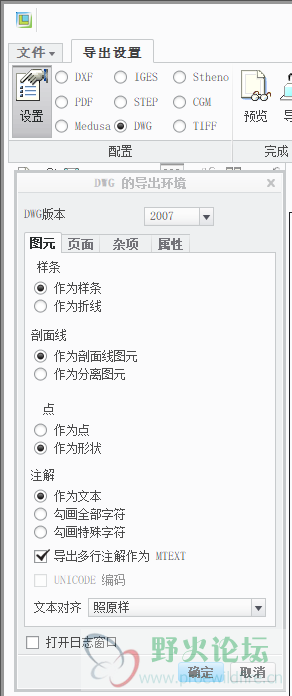

想问这个设置如何保存,PDF能保存但是这个为什么转DWG不能保存,做批量转化用,问一下老师们是否有方法。
DWG转出设置
DWG转出设置

在 config.pro 里根据需要设置这些选项,选项说明自己在配置窗口查看一下
DWG_EXPORT_FORMAT                 2018
INTF2D_OUT_DXF_MAPPING_FILE       D:\ptc\temp\dxf_export.pro
DXF_OUT_DRAWING_SCALE             NO
DXF_OUT_SCALE_VIEWS               NO
DXF_OUT_SEP_DIM_W_BREAKS          NO
INTF2D_OUT_STROKE_TEXT            NONE
INTF2D_OUT_ENHANCED_ENTS          SPLINE_AND_HATCH
INTF_OUT_LAYER                    NONE
INTF2D_OUT_ACAD_MTEXT             YES
INTF2D_OUT_ACAD_TEXT_ALIGN        AS_IS
INTF2D_OUT_PNT_ENT                NO
INTF2D_OUT_OPEN_LOG_WINDOW        YES
