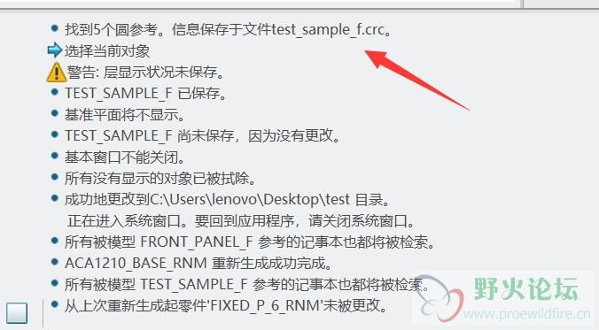

如题,当一个大的装配体出现黄色标志时,通常有以下几点原因
1、某些零件未完全约束(通常会提示某些零件已封装)
2、参照循环
现在模型里出现黄色标志后,重新生成,对话框里的每一个零件显示都是已重新更新,没有已封装提示,所以找不到爆发点在哪里
请教各位大侠,如何在装配体里快速寻找亮黄点?

Good question! You can do it like this.....
Firts. Save and close the assembly.
Then. Open the assembly again.
You can see some imformation as below.
Find the file as show in the picture as txt.
In the file you can see all imformation which feature and prt is cyclic.
And then delet all cyclic references.
After this. you can save and close.
At last. Open again. You will not see the yelow mark any more.

TKS!I know your idea or method.And I do notice the information coming from the lower-left corner.Just do
nothing on it!Or,it is difficult to find the point according to the information of lower-left corner.

要找到.crc这个文件,在刚刚打开软件时的工作目录里面去找,用记事本打开,里面会有那个特征有问题,楼上说的不错。
