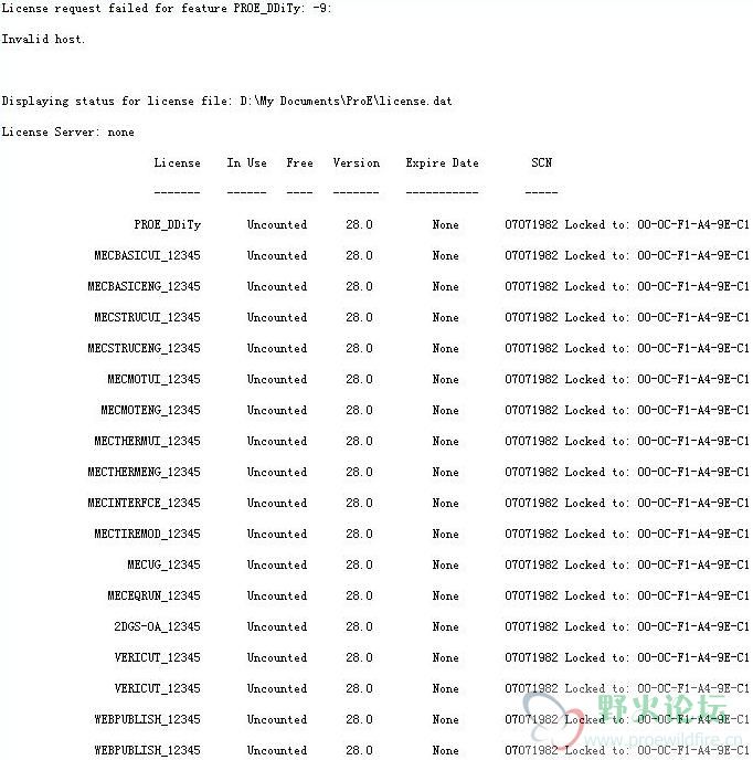

问题是打开PRO——E中出现的提示,截图在附件中

如果是 3.0 M040 以上的版本,都可以对照以下教程安装
pro/e wildfire 3.0 M120 野火版安装步骤图解说明教程
http://www.proewildfire.cn/thread-1028-1-1.html
要点有3个:
1、不要安装 license server
2、自己不会改许可证文件的话用许可证生成器生成
3、装完后运行破解补丁
下次提问请首先说明你使用的PROE版本号

楼主误安装了许可证管理器,也就是安装第一个界面的第一个选项,目前的野火3.0新版本的破解都是采用琐定许可方式,不需要安装第一个选项.
   怎么判断许可证是锁定还是浮动就看第一行
浮动的许可证如下:
SERVER host PTC_HOSTID=00-00-00-00-00-00 7788
DAEMON ptc_d
INCREMENT PROE_Flex3C ptc_d 27.0 permanent 100 54D84EDB73E8 \
        VENDOR_STRING="VSVER=2.0 LO=(0,3,6,7,9,10,14,16,17,19,21,22, \
        23,24,25,26,29,30,31,32,34,35,36,37,40,41,45,47,48,51,52,53, \
        54,55,56,57,59,60,61,62,63,65,66,67,69,71,72,73,74,77,91,92, \
        93,94,97,100,104,106,108,115,116,125,126,127,128,131,133,134,135, \
        137,139,140,141,148,155,156,158,163,167,168,187,188,189,190, \
        191,192,193,194,208,209,210,213,218,219,220,221,222,223,224,251)" \
        SUPERSEDE vendor_info="VIVER=2.0 EXTERNAL_NAME=" ISSUER=PTC \
        ISSUED=2-apr-2006 NOTICE=PTC SN=7C2278215 SIGN=400349D236A0
锁定的许可证如下:
INCREMENT PROE_DDiTy ptc_d 27.0 permanent uncounted \
        93,94,97,100,104,106,108,115,116,117,118,119,120,121,122,123, \
        125,126,127,128, 131,133,134,135, 137,139,140,141,148,155,156, \
        158,160,163,164,167,168,187,188,189,190, 191,192,193,194,208,209,210, \
        213,214,218,219,220,221,222,223,224,251,253)" SUPERSEDE \
        HOSTID=PTC_HOSTID=00-13-72-13-13-6E vendor_info="VIVER=2.0 EXTERNAL_NAME="
浮动的比锁定的多两行,锁定的每个特征模块都要网卡号,浮动的就是第一行需要.
