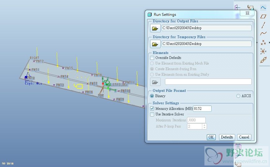

[求助] 结构分析常做到一半就中斷
89
113
发表于 2015-7-3 12:40 | 显示全部楼层 |阅读模式
An internal error has occurred in file s:\sim\engine\src\eng_mem.cxx, line 288.
*** A fatal error has occurred. ***
An error has occurred while requesting an additional
32.299 megabytes of memory from the operating system.
To correct this problem, you may need to increase the amount
of swap space on your system.  You may also need to increase
the memory usage limits that are set for your system.
For large problems you can also try decreasing the
solram allocation setting.
At least 2.0898 gigabytes of memory are needed to run this design study.
Documentation for this issue can be found in the Technical
Support Knowledge base at:
    http://www.ptc.com/cs/tpi/128412.htm
For more information, you can search for the term "swap space"
in the Help Center. To access the Help Center Mechanica
topics, select #Help>#Help Center, set the functional area to
"Simulation" and then click on the "Structure and Thermal
Online Help" link.
調整了仍無效
調整了仍無效

硬盘的交换空间不足!
