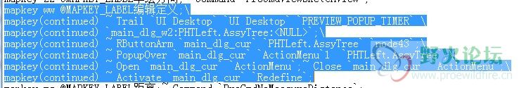

发表于 2014-1-8 22:27 | 显示全部楼层
mapkey ww @MAPKEY_LABEL编辑定义;\
mapkey(continued) ~ Trail `UI Desktop` `UI Desktop` `PREVIEW_POPUP_TIMER` \
mapkey(continued) `main_dlg_w2HTLeft.AssyTree:<NULL>`;\
mapkey(continued) ~ RButtonArm `main_dlg_cur` `PHTLeft.AssyTree` `node43`;\
mapkey(continued) ~ PopupOver `main_dlg_cur` `ActionMenu`1  `PHTLeft.AssyTree`;\
mapkey(continued) ~ Open `main_dlg_cur` `ActionMenu`;~ Close `main_dlg_cur` `ActionMenu`;\
mapkey(continued) ~ Activate `main_dlg_cur` `Redefine`;
