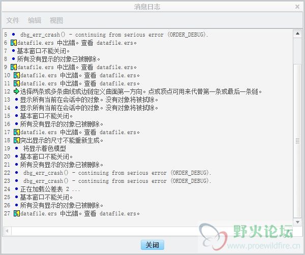

每次打开都显示很多datafile.ers。里面是这些内容,但是没有具体的哪个文件。
ERROR - SYSTEM PRO/DETAIL CONFIG.FILE, line 10:
Keyword 'show_clipped_annotations' is not valid.
ERROR - SYSTEM PRO/DETAIL CONFIG.FILE, line 19:
Keyword 'default_diam_dim_arrow_state' is not valid.
ERROR - SYSTEM PRO/DETAIL CONFIG.FILE, line 39:
Keyword 'modify_driving_dim_by_precision' is not valid.
ERROR - SYSTEM PRO/DETAIL CONFIG.FILE, line 40:
Keyword 'exclude_affixes_from_basic_box' is not valid.
ERROR - SYSTEM PRO/DETAIL CONFIG.FILE, line 48:
Keyword 'symbol_font' is not valid.
ERROR - SYSTEM PRO/DETAIL CONFIG.FILE, line 66:
Keyword 'default_note_leader_type' is not valid.
ERROR - SYSTEM PRO/DETAIL CONFIG.FILE, line 85:
Keyword 'show_hidden_quilt_sket_pnt_axes' is not valid.
ERROR - SYSTEM PRO/DETAIL CONFIG.FILE, line 90:
Keyword 'datum_target_outside_text' is not valid.
ERROR - SYSTEM PRO/DETAIL CONFIG.FILE, line 91:
Keyword 'hole_note_param_translation' is not valid.

把你的 config.pro 和 DTL 配置文件都临时删除掉,然后打开看还有没有
