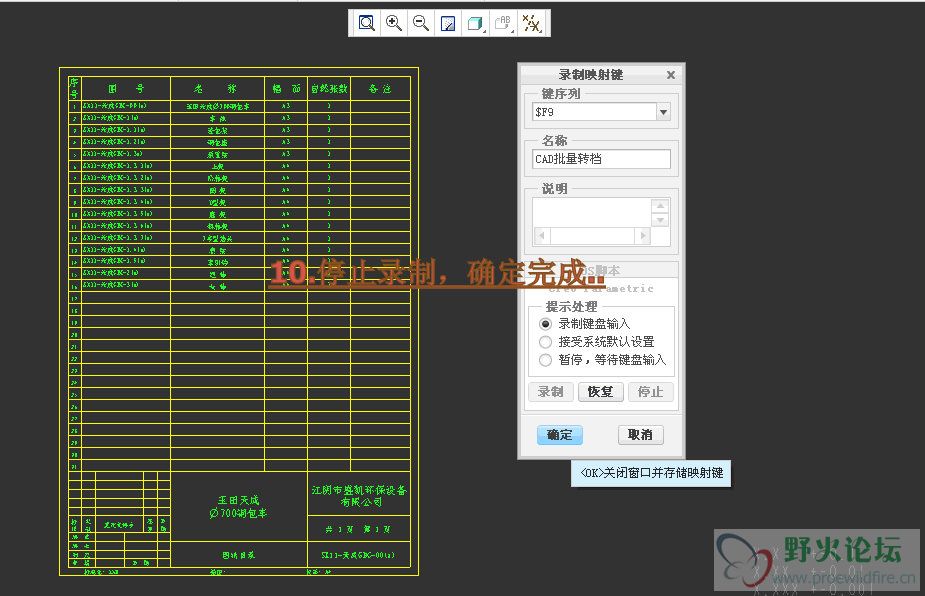

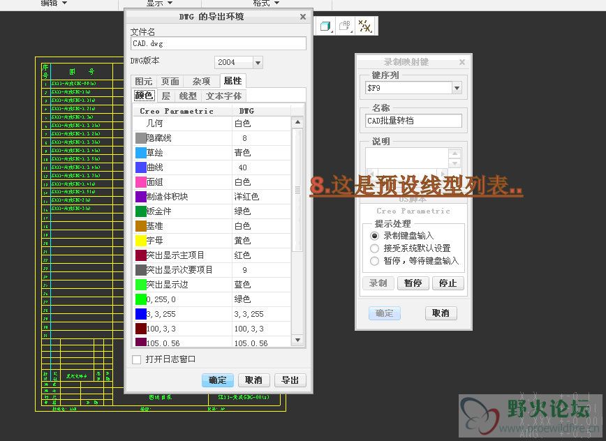

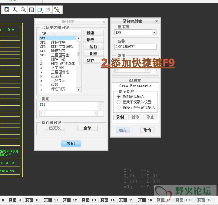

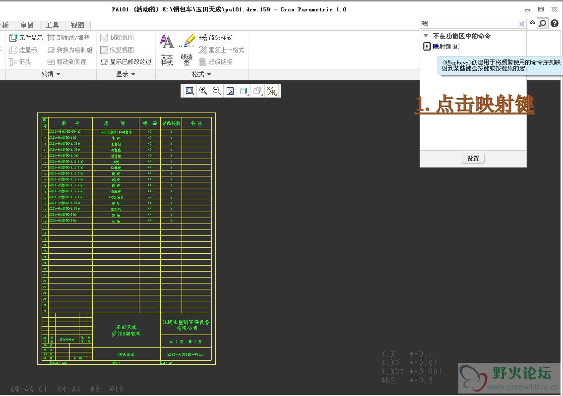

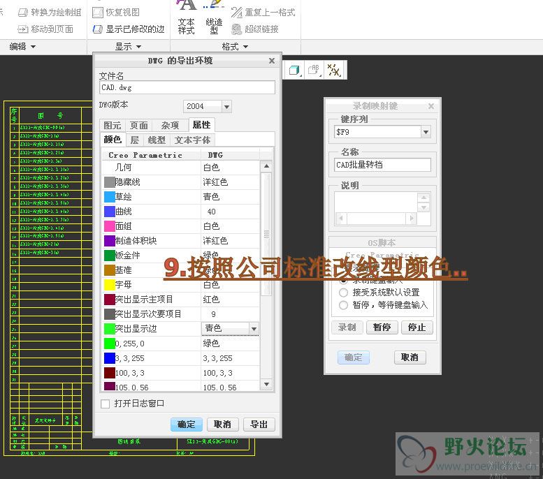

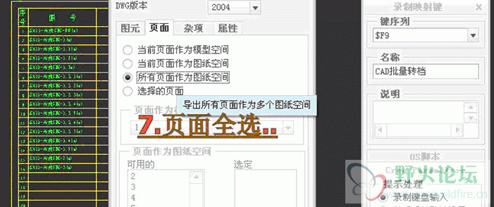

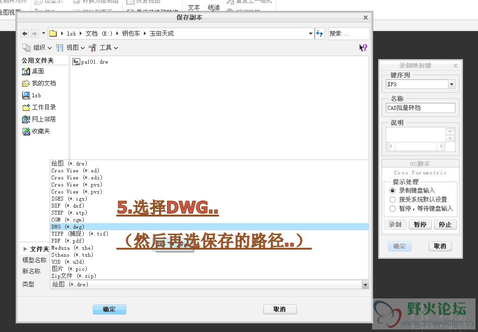

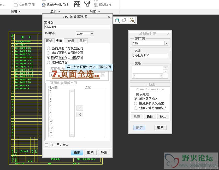

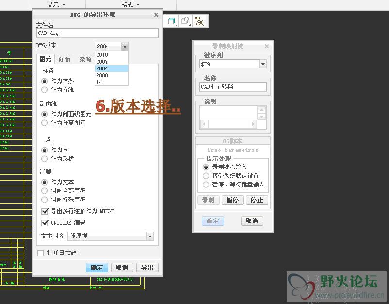

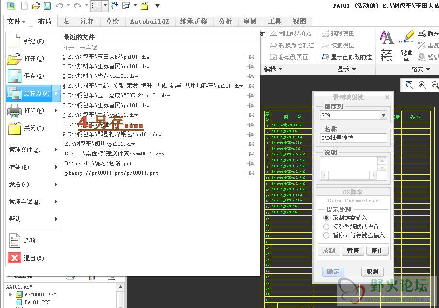

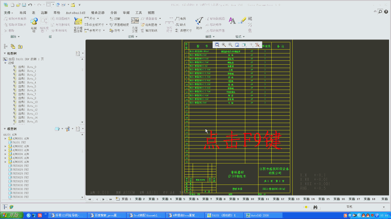

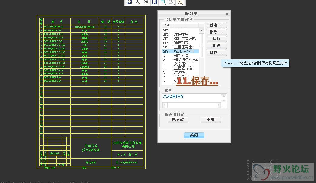

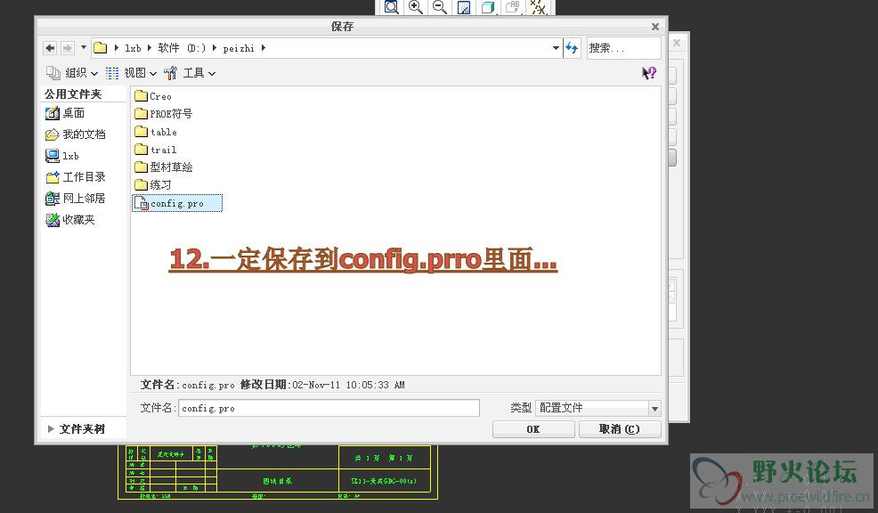

一般公司里都会要求对相关的技术图纸做CAD存档,
对我们用PROE来说最烦:
1.图档线型及颜色;
2.转图时那几个步骤非常浪费时间;
下面我传几张图片来讲述怎么实现一键快速批量转DWG档,分享给大家,不好请不要拍砖!
方法很简单,就是映射键的应用!
看看快捷键转图的速度是不是很快:

 楼主| 发表于 2011-11-2 17:52 | 显示全部楼层
回答四楼的问题:
5.0转档设置代码如下:
mapkey $F1 ~ Activate `main_dlg_cur` `page_Publish_control_btn`1 ;\
mapkey(continued) ~ Command `ProCmdDwgPubSetDeliverable`  `DWG`;\
mapkey(continued) ~ Command `ProCmdDwgPubSettings` ;~ Open `export_2d_dlg` `Version_Menu`;\
mapkey(continued) ~ Close `export_2d_dlg` `Version_Menu`;\
mapkey(continued) ~ Select `export_2d_dlg` `Version_Menu`1  `2004`;\
mapkey(continued) ~ Select `export_2d_dlg` `ExportOptions_Tab`1  `Sheets_Layout`;\
mapkey(continued) ~ Select `export_2d_dlg` `SheetOpt_Group`1  `all_paper`;\
mapkey(continued) ~ Select `export_2d_dlg` `ExportOptions_Tab`1  `Misc_Layout`;\
mapkey(continued) ~ Select `export_2d_dlg` `ExportOptions_Tab`1  `Properties_Layout`;\
mapkey(continued) ~ Arm `export_2d_dlg` `Colors_Table`2  `1` `dxf`;\
mapkey(continued) ~ Select `export_2d_dlg` `Colors_Table`2  `1` `dxf`;\
mapkey(continued) ~ Open `export_2d_dlg` `Colors_Table_INPUT`;\
mapkey(continued) ~ Close `export_2d_dlg` `Colors_Table_INPUT`;\
mapkey(continued) ~ Select `export_2d_dlg` `Colors_Table_INPUT`1  `  7`;\
mapkey(continued) ~ Arm `export_2d_dlg` `Colors_Table`2  `7` `dxf`;\
mapkey(continued) ~ Select `export_2d_dlg` `Colors_Table`2  `7` `dxf`;\
mapkey(continued) ~ Select `export_2d_dlg` `Colors_Table_INPUT`1  `  1`;\
mapkey(continued) ~ Arm `export_2d_dlg` `Colors_Table`2  `12` `dxf`;\
mapkey(continued) ~ Select `export_2d_dlg` `Colors_Table`2  `12` `dxf`;\
mapkey(continued) ~ Select `export_2d_dlg` `Colors_Table_INPUT`1  `  4`;\
mapkey(continued) ~ Activate `export_2d_dlg` `OK_Button`;~ Command `ProCmdDwgPubPublish` ;\
mapkey(continued) ~ Activate `file_saveas` `desktop_pb`;~ Activate `file_saveas` `OK`;\
mapkey(continued) ~ Select `main_dlg_cur` `adbFile_cb`;~ Close `main_dlg_cur` `adbFile_cb`;\
mapkey(continued) ~ Activate `main_dlg_cur` `DetailFile.psh_close_win`;
回答5楼的问题:
你有没有看到第7张图片呢!
[ 本帖最后由 lixiaobao11 于 2011-11-2 17:54 编辑 ]
