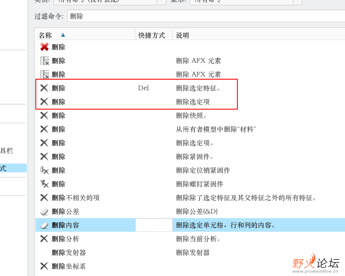

发表于 2022-4-21 20:41 | 显示全部楼层 |阅读模式
到9.0了还是这样,
上面设置了,下面按DEL就删不掉了,真的很不好.
有没有办法呀,用惯了DEL做删除.
63
894
1156
发表于 2022-4-21 21:18 | 显示全部楼层
一个映射键的事,这是我的,要什么可自己改
mapkey J @MAPKEY_NAME删除选定特征及项;@MAPKEY_LABEL删除;~ Command `ProCmdEditDelete`;\
mapkey(continued) ~ Command `ProCmdEditDeleteDwg`;~ Command `ProCmdEditDeleteSket` ;\
mapkey(continued) ~ FocusIn `del_sup_msg` `ok`;~ Activate `del_sup_msg` `ok`;\
mapkey(continued) ~ PopupOver `ScrLayout.1.0` `PH.INST_RMB_.l0` 1 `PH.PIM_chk.l0`;\
mapkey(continued) ~ Open `ScrLayout.1.0` `PH.INST_RMB_.l0`;\
mapkey(continued) ~ Close `ScrLayout.1.0` `PH.INST_RMB_.l0`;\
mapkey(continued) ~ Activate `ScrLayout.1.0` `PH.DELETE_PB_.l0`;

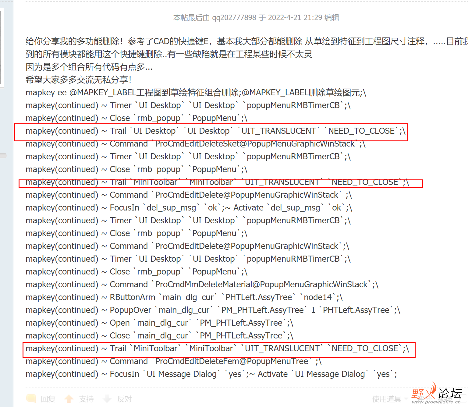

发表于 2022-4-21 21:24 | 显示全部楼层
给你分享我的多功能删除!参考了CAD的快捷键E,基本我大部分都能删除 从草绘到特征到工程图尺寸注释,.....目前我用到的所有模块都能用这个快捷键删除..有一些缺陷就是在工程某些时候不太灵
因为是多个组合所有代码有点多...
希望大家多多交流无私分享!
mapkey ee @MAPKEY_LABEL工程图到草绘特征组合删除;@MAPKEY_LABEL删除草绘图元;\
mapkey(continued) ~ Timer `UI Desktop` `UI Desktop` `popupMenuRMBTimerCB`;\
mapkey(continued) ~ Close `rmb_popup` `PopupMenu`;\
mapkey(continued) ~ Trail `UI Desktop` `UI Desktop` `UIT_TRANSLUCENT` `NEED_TO_CLOSE`;\
mapkey(continued) ~ Command `ProCmdEditDeleteSket@PopupMenuGraphicWinStack`;\
mapkey(continued) ~ Trail `MiniToolbar` `MiniToolbar` `UIT_TRANSLUCENT` `NEED_TO_CLOSE`;\
mapkey(continued) ~ Command `ProCmdEditDelete@PopupMenuGraphicWinStack` ;\
mapkey(continued) ~ Command `ProCmdEditDelete@PopupMenuGraphicWinStack`;\
mapkey(continued) ~ Command `ProCmdMmDeleteMaterial@PopupMenuGraphicWinStack`;\
mapkey(continued) ~ RButtonArm `main_dlg_cur` `PHTLeft.AssyTree` `node14`;\
mapkey(continued) ~ PopupOver `main_dlg_cur` `PM_PHTLeft.AssyTree` 1 `PHTLeft.AssyTree`;\
mapkey(continued) ~ Open `main_dlg_cur` `PM_PHTLeft.AssyTree`;\
mapkey(continued) ~ Close `main_dlg_cur` `PM_PHTLeft.AssyTree`;\
mapkey(continued) ~ Command `ProCmdEditDeleteFem@PopupMenuTree` ;\
mapkey(continued) ~ FocusIn `UI Message Dialog` `yes`;~ Activate `UI Message Dialog` `yes`;

 楼主| 发表于 2022-4-22 06:54 | 显示全部楼层
行,只能改变操作习惯了.每次特别不自觉的去按DEL
189
844
1256
 楼主| 发表于 2022-4-22 07:02 | 显示全部楼层
这些是鼠标轨迹,可以删掉,没有意义,还有你录的时候,尽量一个一个精减,会特别简单,否则篇幅太大.
那个TIMER我记也得也可以删掉的.太多不好判读.录一个删掉一下,有的只要一句话

发表于 2022-4-22 11:11 | 显示全部楼层
那个TIM ...
不不不,很多鼠标轨迹是用来聚焦的,窗口失焦会导致很多步骤是失败的

 楼主| 发表于 2022-4-22 13:40 | 显示全部楼层
我录的很多快捷方式 ,从没留过轨迹语句,都是很简洁的,从没出过错.
